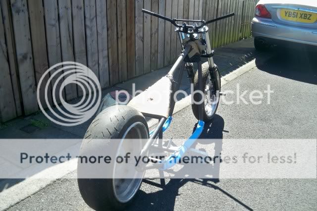

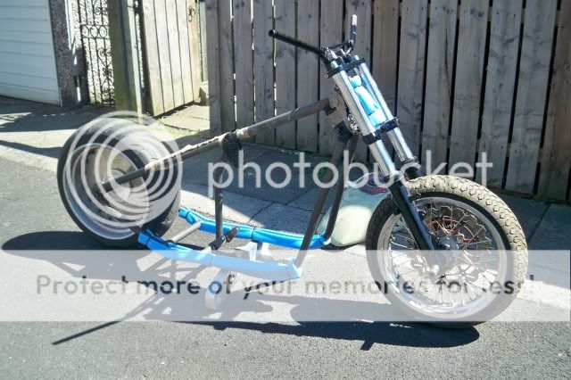

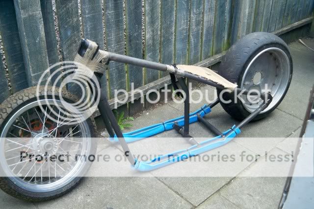

Next up,this ones going to an exile style chop. Blasted satin alloy with black paint. Boring....lol.
Its going to have a 7x17 split rim in the rear with a ktm wire wheel up front.
The handlebars are not staying!

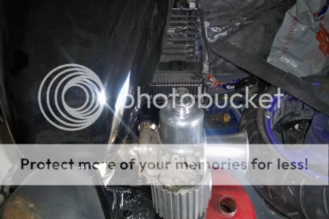

Ive started making a few things for this. ive made a start on an inlet manifold for an SU carb and Ive made a start on the exhausts.

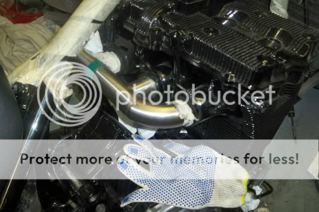

The exhaust for this one is going to be a mr turbo style thing. Ive made a start on the 1st 2 pipes. All welds are going to be ground off to make perfectly smooth.
The pulley wheel propping the carb in position is from the chop that was on the cover of BSH a month or two ago,built by my good mate Robbie (NSU chop). The supercharger set up is now mine as the NSU was chopped up.

Not sure about the single SU-carb, but please post some updates on how the engine behaves... in theory it should end up being awfully sluggish and not willing to rev, but all theory is gray, y'know ?

Thanks for comments nanno. The SU carb idea has and is working fine on a couple of my friends bikes,one a gpz11 engined z650,with no issues. I realise the SU cos of its design is a "slow" carb with reactions,but i fancy trying it out. If it doesnt do what it should,i'll stick a weber twin 40 on. :)

Personally,i think the build quality is top notch on the frames,BUT,the frames sit too low,the angle of the down tubes i think should have been matched to the donor bike frame (whether blandit or gsxr etc),to allow you to use things like exhaust headers from the donor. If i had a jig,id use a HUC frame as my bases for a starting point,and then just alter a few angles.
The idea that they are a kit,is a little misleading in my mind,as you need to have access to some decent equipment to make things go together. As an example,you go try to find an exhaust that will fit.......(unless you go buy a HUC one at 295 quid!).

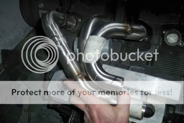

A bit more today,this for number 2 bike,the one with the split rim on the rear/wire wheel on the front. I think?
I really need to make some exhaust flanges etc to bolt things to the head before i go any further. Trying to hold 3 pipes,one of which isnt welded,together to work out angles of dangle etc is frustrating.
I also need a new welding helmet,as the close the eyes and hope for the best,isnt constructive to a good finish. But,the welds will all be ground off.
